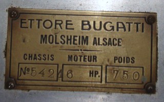

Built in Molsheim, yes or not?
Or number allotted subsequently on an existing frame?
See: http://www.bugattirevue.com/revue13/54.htm

Yes it's correct, because it has been imported to Switzerland in the 30s and after than the car has been returned to the factory (engine problems)

I dont remember it being returned with engine problems,when i sold it ,it had no engine.

#54206 - Bucar (CH) returned and dismantled

That is 206, not 216.
Was 216 not one of the cars that you assembled, Lazarus?

As I said in my previous note,I assembled the car .it was not returned to ME with engine problems !

206 and 216 are not the same. 206 was returned in the 30s to Bugatti. I wonder what happend with the frame. Went into a type 55?

It hasn't been returned to you John, because dad hasn't had engine problems with it, and it would be very hard to complain about the engine when you sold us a cylinder block and numerous bits! Correct me if I'm wrong, but my understanding was that the plate was an original un-numbered plate, stamped with a new Type 54 series number, the number not having been used or allocated by the factory? Of course I may have completely the wrong end of the stick.

The plate is a BOC one or french but recent manufacture,not original.I stamped the number so as not to confuse the issue.This is clearly an impossible number for a T54.Have you driven dads car Daniel? I had five years of genuine pleasure with this car.I had to lift off twice going up Brooklands test hill ! Otherwise I was in danger of going into orbit without a spacesuit.Straight lines were not a problem but bends did require common sense.

Re 54216, no i've not driven it, but have spent much time in the passenger seat. Fantastic toy, great fun, if slightly scary, even from the passenger seat! What it would be like with the blown 4.9 in it one can only imagine! A type 50 will be a nice, if slightly more civilised alternative.

a few T54 drivers died at the wheel....not the most useable Bugatti.Very scary yes,and that was just with the Jaguar 3.8 litre motor,as you say a full blown T54 must be terrifying.
