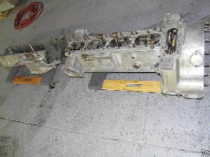

I think your qustion is my answer . So early 57 have a solid mounted engine and later ones are rubber mounted . How looks the solid mounting ? It looks like the one on the foto with the rubber is a late conversion original it was a solid one .
 Post subject: Re: Atlantic question
PostPosted: Tue Jun 12, 2012 9:35 am
Hi,
Changing fron solid mounted to rubber mounted would require a crankcase change as the solid mounted T57 engines were fixed on 4 points to the chassis.
None of these early crank cases had a compressor drive if I'm well informed.
As reproduction parts I only know rubber mounted crank cases from C&G.
Greetings:
minime

Early solid mounted engine

I think , this 57 chassis is converted from solid to rubber mounts at the rear . Look at the holes in the chassis . The mounting plate went some cm forward . How looks the front engine mount ? How is it bolted to the chassis ?

its moved but not sure why? what is the year or better the # then you will know what was the original engine.
PostPosted: Tue Jun 12, 2012 3:56 pm
Hi,
It looks moved but not converted from steady to rubber mounted.
The steady mounted engine is fixed further in the front with 4 bolts per attachment.
There are also some other differences for the cross members of the chassis (at least for the standard T57 chassis).
On early T57 with steady mounts it's for example possible to remove the gearbox without removing the engine what apparently can't be done on the rubber mount chassis.
minime
