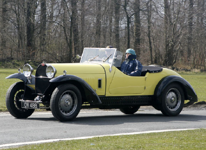

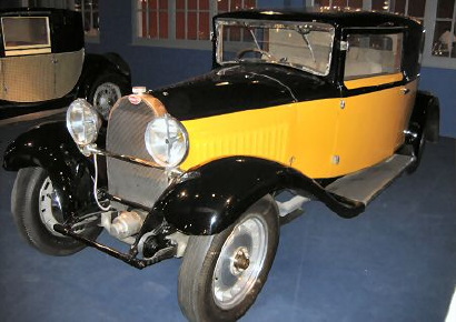

I do not believe this to be an unknown T50, registered OW 498 (GB). Look at that dynamo type thingy at the bottom of the radiator - would seem to indicate a T44 or T49 (photo of 49471 included as means of comparison). The length of the bonnet and the track also seem more like that of the smaller touring Bugatti.
PS. Yes indeed, very slow day at work. Why do you ask?
PostPosted: Thu Dec 18, 2008 2:23 pm
Thank you Johan
I share this observation. But it is not a type 44, the wheels are those of a type 49
Christian
Update: http://www.bugattibuilder.com/wiki/inde ... own-OW_498

Graham Little's database :
OW 498
The UK registration carried by a type 49 with engine L328 and siderails from car 49421 and 44922. Two-door tourer. Imported by H.F. Moffat and sold the same year to John Hallam, Leeds. Engine rebuild by Dutton. The car has featured in “Bugantics” B.59/1/21, B.60/3/27 and B.64/3/19.
