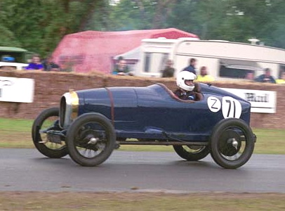

On the stand of Christoph Grohe at Retromobile 2003, the new edition of 4008, the ex U.Hucke Strassbourg car, now with a body similar to the ex Junek 22/30, surely a body which is more usable for a client than the 29/30 monoposto body which it had before that. The first body is like the one below, however, Wiki says that's 4004. I do not know how much of the car is a replica, but at least both bodies on 4008 were replica's!
From Christoph Grohe in 2003:
T30 compétition, roadster, chassis #4008 (Type 23), engine #4003.
Delivered on November 16th, 1922 with a body "course - réservoir ovale". Uwe Hucke acquired it in 1968 and rebodied it in the way "Grand Prix of Strasbourg" (cigar). Restored recently with a more useful body, a copy of Elizabeth Junek's type 30 (#4001 ).
It is the most early Bugatti 8 cylinder known. Available survey report on inquiry.

the photo of "the cigar " does`nt show "cigar" but the T29/3o indianapolis racer, also rebuilt by uwe hucke !!!
regards
mike

PostPosted: Mon Feb 02, 2009 8:42 am
The 29/30 racer was the "first" body on the chassis that is now called 4008. Probably the body was removed, and put on another chassis? I called it "cigar" by mistake, I know that that's an altogether different car.
