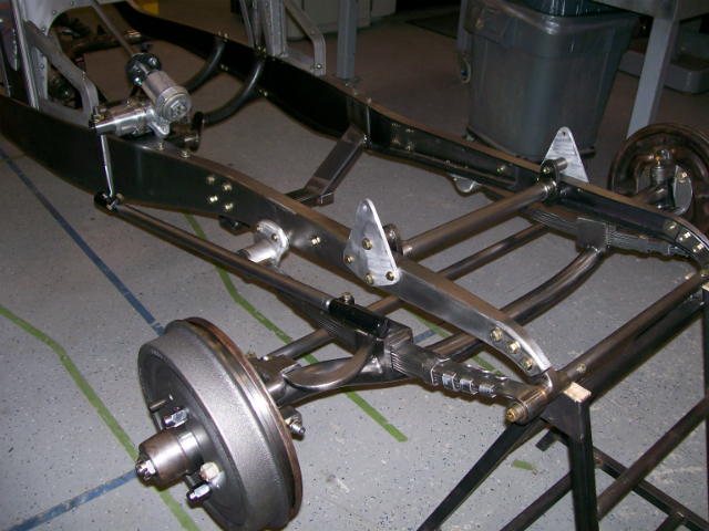

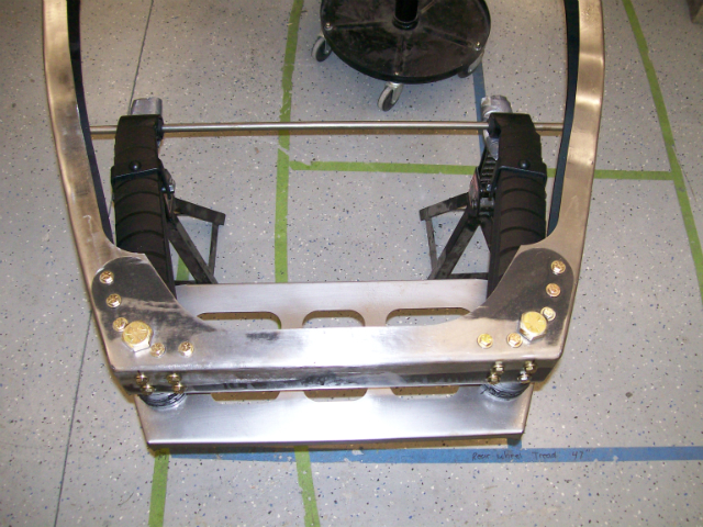

I haven't posted about this before but I have been building a pretty serious T-35 replica for about a year now. Going through a tremendous amount of research and work to make it as realistic as possible. Just got it steering this past week. Picsd attached.

Nice work Dan,I hope you are going to fit a few Bugatti nuts and bolts.I am surprised that you didnt use a real front axle at least.A T44 or T49 front axle wth stubs would have improved it a lot.I doubt that it would have cost much more than what you have done .

you made all this parts ? Or did you buy all or most of it , and where ? I hope to see more fotos in the future .

Nice work Dan,I hope you are going to fit a few Bugatti nuts and bolts.I am surprised that you didnt use a real front axle at least.A T44 or T49 front axle wth stubs would have improved it a lot.I doubt that it would have cost much more than what you have done .[/quote]
Thanks. I really didn't want to get into the cost of reproducing a T-35 in every aspect. I will not call this a Buigatti when I am done - just a GP car inspired by Bugatti. So, I didn't want to be tied to using Bugatti style brakes and backing plates, etc... I wanted to use Hydraulic brakes so I decided to make the axle to my specifications so I could use the brake system I wanted.
I am also running an Alfa Romeo drive-line that I collected a few years ago.
Myh theory on this is that it isn't and never will be a Bugatti - no matter how much money and time I put into it - so I figured I would take liberties where appropriate to make it a little bit Bugatti and a little bit me.
Either weay its been a tremendous amount of fun.
Dan
Yes - I made everything you see other than the brake drums and the backing plates. The rear-end is Alfa Romeo.

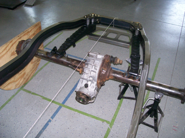

can you show a foto with the back axel ?
I haven't narrowed the rear end yet, but here is a current photo. I really haven't spent too much timew on the rear-end yet. just starting to figure out my axle/backing plate setup this week.
