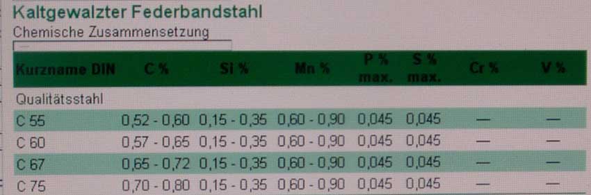

And you forget the 1.65% SI, 0.85% Mn and in some cases 0.5% Cr which does not make it ordinary carbon steel as claimed by the engineer.

I do not know how many chemical analysis you made from original parts ? But for all parts we made for aircraft including leave springs I made one . Because in the end an aircraft inspector has to sign for and likes to see some papers . The only real differend is the carbon .
If I buy a bigger amount like 1000kg and more , it is very much the same price like normal construction steel. So the differend can not be so big .
