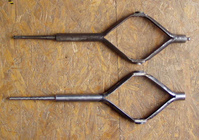

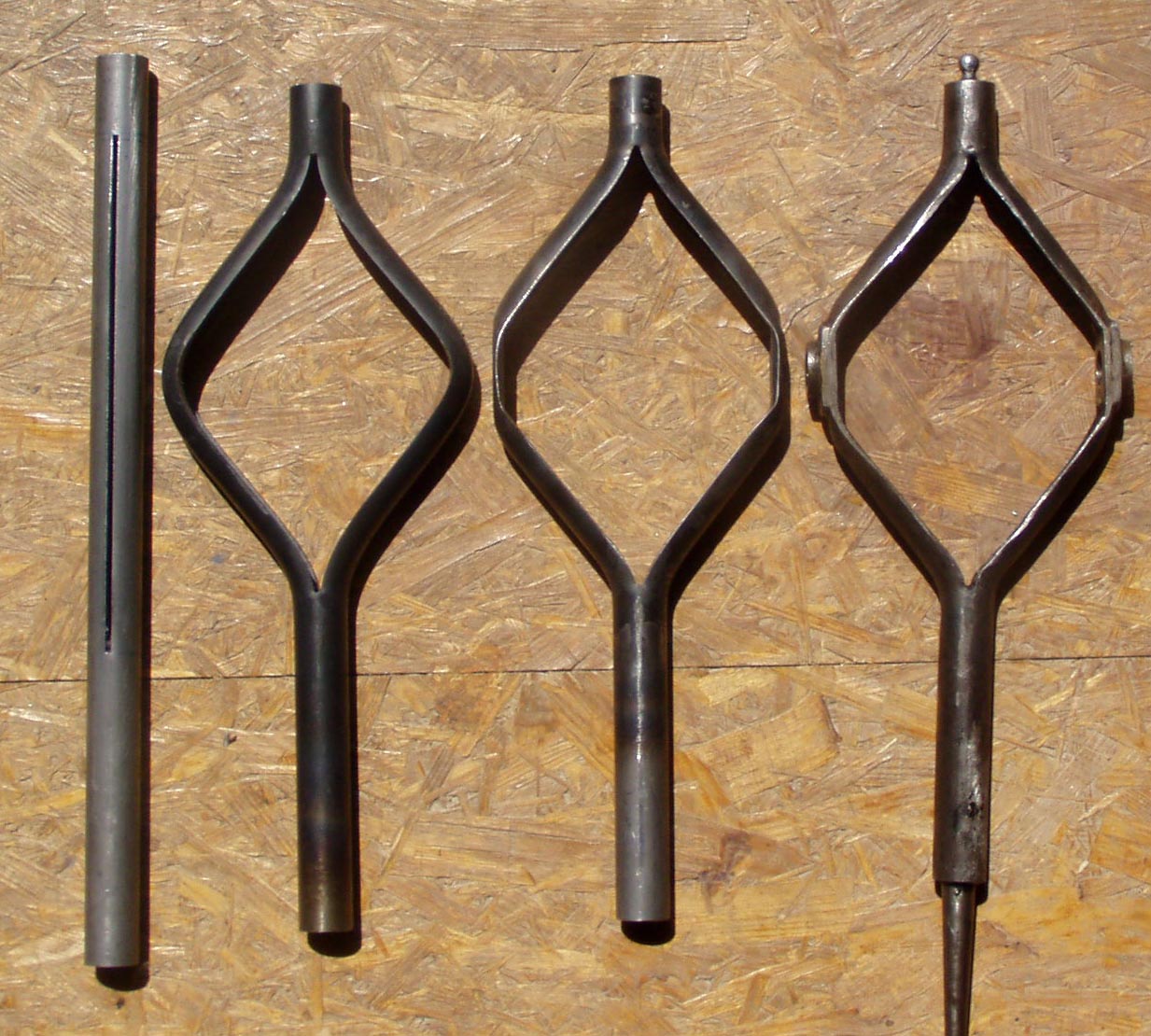

first one is ready . The top one is original . Tube 22mm x inside 14mm

Udo - looks good. What did you use to cut the slit in the tubing? Just curious.
Dan
 Post subject: Re: Bugatti part .
PostPosted: Fri Jun 17, 2011 3:18 am
in a milling machine . disk diameter 80mm , 2,5mm wide , 50 tooth.
