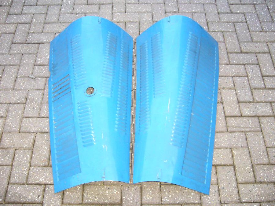

I have been told that a Type 35 bonnet was made from only two pieces of aluminum. The welded seam parallels the top of the bottom row of louvers. A quick examination of the Simeone collection's car seems to confirm this. However, I cannot figure out how the top piece was made to have a compound curve along its length, and then have two different curve profiles at the firewall and the radiator. This is not as simple as it looks.
Does anyone know exactly how these bonnets were/are fabricated? I've spoken to someone who made an excellent reproduction in the 1970s who told me he used 6 pieces welded together, but I've also been in contact with someone who told me he has seen new ones made as the original with two pieces.
Any tips, links, or information would be much appreciated.
File comment: Notice the compound curve along the length of the bonnet. From about 1/3 in front of the firewall in bends noticeably inwards. The profile also changes from the firewall (tight radius) to the radiator shell (more open radius.)

I am in the middle of fabricating a T-35 hood now. First off, explaining years of sheet-metal forming experience is tough, but....
First, I would make a really good wooden form so you know what the shape is, and you know when you have achieved it.
Doing each half in 2 pieces is correct. the weld seem is right above the lower row of louvers as you mentioned. the upper piece (with the compound curve) can absolutely be made of 1 piece.
You need to stretch the aluminum to form the compound curve area.....but not the edge that mates up with the lower piece or the hinge edge.
this is done on a large power hammer (if you have one) or an english wheel. There are methods of stretching the aluminum over a form, but that is much more equipment intensive. You could also do it with a hammer and a sand bag, then use a planishing hammer to smooth it all out, but symmetrical replication is difficult.
The fact is that it is a difficult piece to make if you have never done an metal shaping and don't have a power hammer, planishing hammer, and the appropriate hand tools.
You also need to hem the edges, which can be difficult around curves but is certainly attainable.
Then you have all those louvers !!
I would be happy to talk with you about this some time.....let me know if you would like to do that.
