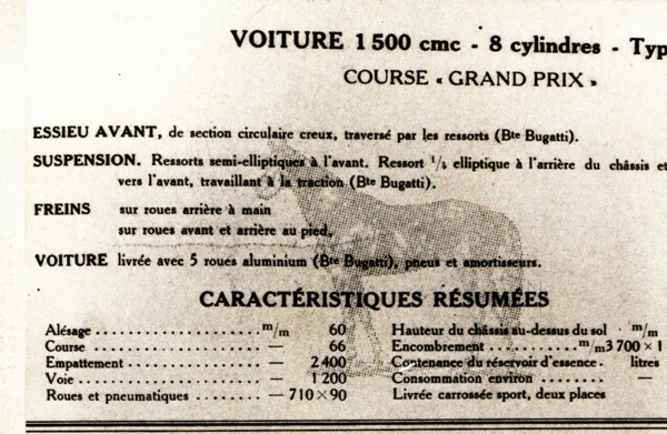

Hi Michael,
also I don't understand your question, as we to know the type 39 1925 was already driven
1926 Bugatti catalogue presenting the 1.500cm³ type 39

Seems that nobody took the time to read the page I posted above as graphic.
So here are the essentials Hucke/Ulrich/Kruta are stating in their book:
The original 5 unsupercharged T39 from 1925 had a bore x stroke of 52 x 88 mm, by using a T35 block with reduced bore. For 1926 a supercharger was added with bore and stroke remaining unchanged. For 1927 then the cars prepared for the GP de l'ACF had 54 x 81 mm, but the power output was still disappointing, so they finally changed the engines of these cars to 60 x 66 mm by using the same crankshaft as that used for the T36 (1100 cc) model.
I don't know Michael Ulrich, but the late Uwe Hucke surely was one of the most knowledgeable Bugatti historians, and also Julias Kruta is no nose picker. For me "From Milan to Molsheim" was always some kind of a bible, despite some small mistakes.
So if even the official Bugatti catalogue for 1926 shows 60 x 66 mm, how can they write such b...s...?
