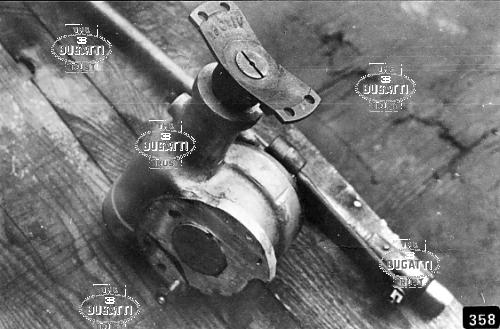

Hi Udo Im intrested in the second seris T13 1612 to 1650? what was the engine in the car you had?
Did it have a sepperate steering box?

yes , with a separate steering box .

PostPosted: Fri Jun 15, 2012 11:58 am
Do you have a photo of this area on your car?

For a good photo of the separate, bolt-on (and adjustable) steering wheel, see page 31 of the Italian Bugatti Register 2009, chassis 1645 with engine no. 40. I cannot scan it for you, sorry.
I say "adjustable" because the flange on the upper crankcase has a series of holes which enable you to set the angle of the steering box (and, thus, column) according to coachwork and seating requirements. The design was obviously a weak point, as it was replaced by the truly integral steering box after 75-100 engines (the number is higher than previously thought.) I used to own engine no. 5 ex-1615 and part of the flange had broken off earlier in its life.

Hi Sandy,
You are tust the man.
The trust have a great photo as well im interested in the cars, my belief is that they may all have been T13 with twin magnetos but im looking for more examples. sadly there seem few period photos.
Whats your view on 1612 -1650? were they all race cars?

my car had the long bronze steering box ,
 Post subject: Re: Brescia modifiee
PostPosted: Fri Jun 15, 2012 2:42 pm
Thanks Udo thats the early box the cars im interested in is the seris that imediatly followd yours.
