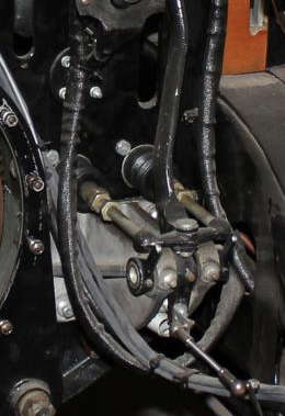

It looks like the old engine mount with no rubber .But 2 master cyliner , one for the front and one for the rear .

The picture you posted is quite small but is that an electrical brake pressure switch they fitted there?

It seems that on another picture there are well two feed lines going down to the master cylinder area so there are 2 cylinders fitted.
