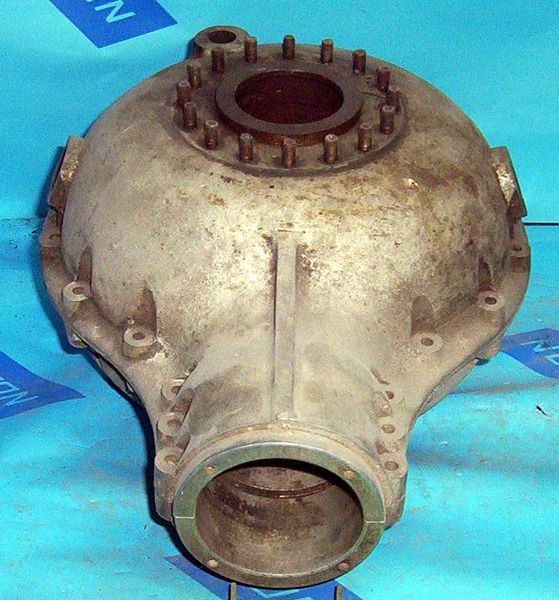

how can it be , totally different type of fixing to the axel trumpet ?
 Post subject: Re: T57 differential
PostPosted: Mon Jun 18, 2012 11:25 am
Hi Udo, that is a late centre casing with the ribs, Trumpets to this will not fit the older style diff or vice versa, the late T57 and Brescia are two types that have less interchangability attched is a photo of an early T57 casing i beleve its essentaly the the same as all other 4 bolt touring cases.
Yours i beleve also has 9mm bolts?
