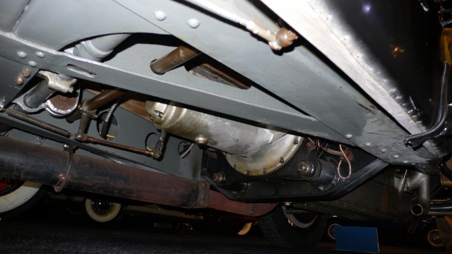

can this be an 57s sump ?
 Post subject: Re: 57s engine
PostPosted: Sat Jun 23, 2012 9:06 pm
Looks like.

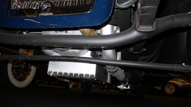

do you have a foto from a normal 57 sump ?
PostPosted: Sat Jun 23, 2012 10:24 pm
I can take one by tomorrow when I lie down under our car.
Basically it's rectangular as long as the engine with short cooling fins and it has a capacity of 15 liters of oil.
The 57s had dry sump if I'm well informed.
The attached picture was from that T57 Galibier that was hanging in that castle near Dijon.
I took the picture at the London auction.
Greetings:

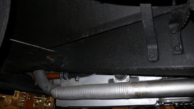

Here they are...
Greetings:
minime
PostPosted: Sun Jun 24, 2012 3:20 am
I can't really see any big difference .The 57s sumpf is supposed to be less high compared to the normal one . How much , maybe only some centimeters ?

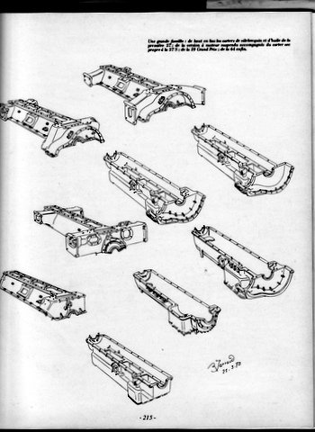

But maybe if you spent a bit more time in the book world, you wouldn't have to waste so much "real world" time, by asking such inane questions. :wink:
PostPosted: Mon Jun 25, 2012 10:04 am
workshop manual, revue technique etc ,....all have valuable information content...
more so informative drawings..as shown
PostPosted: Mon Jun 25, 2012 12:40 pm
Yes but so much easier to ask everybody else.....
