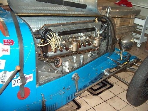

Who knows the history of 4842?
i have this picture, but forum user "Hunter" comments that this chassis number is also used for a 35TC, which broken down somewhere in the past.
-double number?
-35A engine installed after breaking down the 35TC engine?
PostPosted: Wed Feb 27, 2008 8:03 pm
I got reaction by Email:
Judging from the picture in the WIKI, this car never has been a T or TC.
No hole in the dashboard for the magneto, no rev counter above the steering wheel.
If a GP block has been used, these holes should be there, and the rev counter usually still is present.
So very probably no T or TC

The car on the photos definitively is a T35A.
However, that does not mean that #4842 was a T35A, or in other words that the shown car is #4842.
For me this question is rather important, because #4842 may have been the most successful German racing Bugatti ever.

Please do not stop this thread. I'm afraid I am still confused about both the identity of the car in the photo, and it's original specification. And how different is that to the its specification now? Is this 4842?

As the distributor cannot be in the same place as the steering column, it needs to be moved as well. Quite an operation.
No, don't forget the engine was the DOHC 51A type, with the magneto driven by the left camshaft.

The identity of a car is not decided by the engine but by the chassis.
I understand the car in Mulhouse is 37350 with engine 2 ex 51134.
Concerning "4842", the fact that the engine of the car currently has a distributor driven at the end of the cam makes it look like one of the three versions of a 35A engine but it still could be based on any other 35 engine.
Is it known on what the identity "4842" is based other than the convenient fact that the real 4842 is lost? This car needs to be inspected properly.
PostPosted: Fri Feb 29, 2008 8:40 am
I agree on that. In the books the 4842 is a type 35B.
However, the photos show a type 35A or drastic alterations to the car.
About the monoplace: Putting in a dohc engine surely makes life easier, with the distributor being not in the middle.
