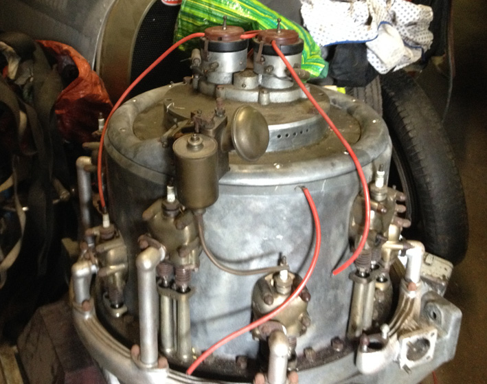

Who has any info about this engine .

Is this the Rotary head engine? 4 cylinders on two crankshafts, set-up in a square, with the head rotating on top of it (Patent applied for by Roland Bugatti).
Where is this engine now?

Udo/Jaap: I see 5 spark plugs in the photo so I would expect not a 4 but an 8 cylinder ?
I see no rotating head.
Form further observation:
this could be a 8/10 cilinder radial engine (2 rows of 4/5) sidevalve
Cylinders enclosed in a jacket
Pushrods driven by a ring ?
Common exhaust
Inlet ????

10 cylinder , 2 rows , side valve , bronze cylinder heads ,sidevalve with pushrods , complicated intake system with one carburetor for all , normal exhaust system , 2 magnetos , underneath a 90 degree gearbox with a vertical shaft to the gearbox .
but who made it and for what kind of car ?

I thought it was, on this forum, a Bugatti engine.
It must be some kind of swash-plate engine, though I do not know the type.
As this seem to be a new quizz:
Who does recognize this V20, one center camshaft (automatic inlet) engine??

Because this engine is in a big private Bugatti collection , I thought somebody know about it , and maybe it is a Bugatti design .Your 20 cylinder aircraft engine looks very similar to an antoinette engine . I am used to work with this kind of engines .
