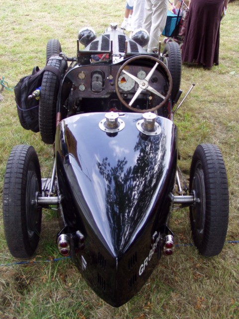

FWP 556 (GB), Brighton Speed Trials (UK) 1947, G.N. Richardson
T51A or T37A ????
T51A GP (#51138) GR 8894 (GB), Powderhamshow (UK) 2006

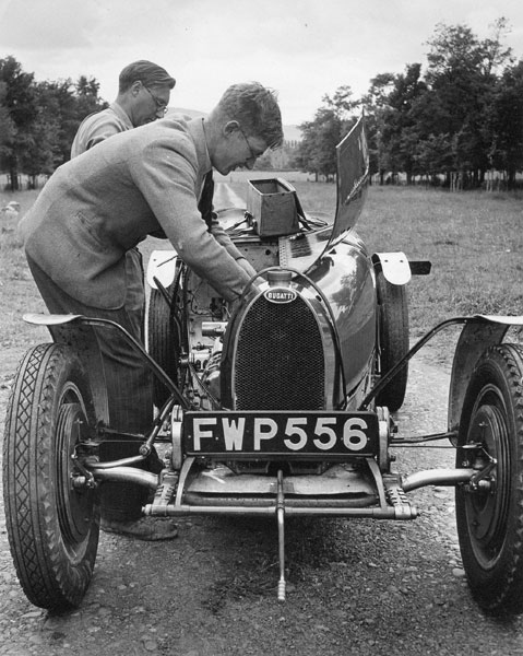

Further thoughts.
The top picture is correctly described as Brighton. Could the lady talking to Richardson be Monica Whincop (née Strain) ?
However, the two below are from the Dacre Stubbs collection and show the car at Madresfield sprint in the grounds of a stately pile set in the soft underbelly of rural England (Worcestershire ?). The venue is still used by the Vintage Sports Car Club for driving tests.
The car had been rebuilt after being the victim of a German bombing raid which might explain the narrow radiator.
Did Wimille actually race the car ? According to my records the only time he drove a type the 51 in 1932 was in a Formula Libre race in Casablanca where a 1500cc car would have been completely outclassed.

The photos with Richardson show clearly the single tank filler and the conversion from central magneto to leftsided one, which would confirm the conversion from SOHC car. However, dash is not original.
