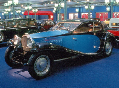

To find some respite from the T51 jungle, I thought I would do a post on one of my favourite touring Bugattis, the Coupe Profilee T46 now in Mulhouse. Most of the information comes from L.G. Matthews Jr.'s Bugatti Yesterday and Today.
The history of the chassis :
46482, engine 327 was one of 4 unused T46 chassis' kept by Roland Bugatti, 2 of which were sold to Richard Baudens during the early fifties, who then sold 46482 to Don Stanford, who in turn offered it to Russ Sceli in 1952. Sceli did not buy the car, but put Stanford in touch with Eri Richardson, a Bugattist from Washington, who then took delivery of this brand new chassis.
The coachwork :
Having no body for his new Bugatti, Richardson then travelled to France in search of suitable coachwork and after several years of searching discovered a Profilee bodied T50 behind a barn. Form the pen of Eri Richardson the following : "The two spare wheels had been left of, (and) the top had been profilated right on down to the base of the petrol tank; the rear wings had been cut back to a complementary curve. So far as I know, this was the only coupe so done at the works" This body, still mounted on its original T50T chassis was then shipped to Richardson's home in Washington where it was restored (very well, it would seem) and mounted on the unused T46 chassis. Matthews makes no mention of the fate of the T50 chassis.
In 1959 Andy Rheault bought it from Richardson but due to a temporary cash-flow problem was forced to put it on the market a short time later. In December 1960 Derry Mallalieu at Grand Prix Engineering in Norwalk offered the car for sale at 4500.00 Dollars. It remained unsold until July 23, 1963 when Fritz Schlumpf bought it and had it shipped to his collection.
In an effort to discover the chassis number of the T50 donor car, L.G. Matthews requested Patrick Garnier of the Mulhouse Museum to search the archives for any information. The search revealed nothing, nor are there any meaningful numbers on the body, so the origins of the body remain therefore unknown.
I have only ever seen photographs of one Full Profilee T50T, the two-tone (probably black and ivory) car displayed at the 1932 Paris Salon after it was photographed (minus front bumper) outside the factory. That this is the same car is merely an assumption on my part, nor do I know whether Eri Richardson was correct in his belief that only one Full Profilee was built.

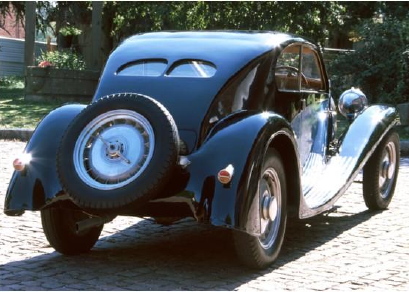

Using photographs from Wiki and the Bugatti Trust's album No.14 I present the following for comparison. As can be seen the bodies are very similar, but the treatment of the rear wings reveal significant differences. The way the front windshield is mounted also appears different. These 2 bodies are very similar indeed, but not identical. Therefore I cannot, in all good conscience, declare them to be the same. Once the Saunier, Klein & Jansen work arrive (hint, hint) this mystery should be solved. In the mean time, share with me in celebrating the extraordinary talent of Jean Bugatti.
