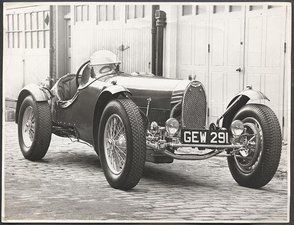

PostPosted: Sun Aug 31, 2008 5:19 pm
GEW 291 at Prescott 1948 > 51155 ?
" ... The car was then rebuilt by Monaco Engineering (shop where Monkhouse and Fletcher were working) as a special bodied two-seater for R.O. Ayrton, using a Type 35 chassis frame obtained from Stafford East, equipped with a larger touring from axle, Wilson gearbox and wire wheels. The car was registered GEW 291. After being used in this from for sprints and hillclimbs, the car was up for sale at Chiltern Cars in September 1953. It seems that nobody was interested in the car and 9 months later it was still for sale. During that famous cold 54's winter, the engine had been frost damaged, and it was considered to part out the car..."
Great picture.
I think that's the special, but are you sure for the date, 1948 ? Because the engine is not a Bugatti's one and the Ford engine was fitted after 1954.
PostPosted: Mon Sep 01, 2008 9:12 pm
at Prescott, June 1948, P. R. Monkhouse
