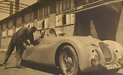

- #14 Grand Prix de l'ACF 1937 :
Engine n°: type 50B 4.5-litre
Year: 1937
Licence plate: 2103-W1 (F)
Owner: Automobiles Ettore Bugatti,
Type 57S45 Grand Prix
Jean Bugatti brought this second 57S45 of Molsheim to Montlhéry. Arrived late after a fixing on the road. Both 57S45 did not take part in the race

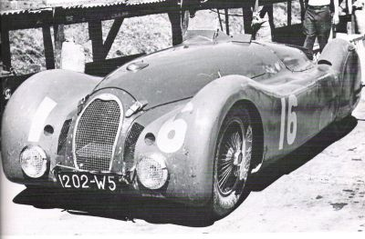

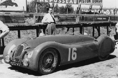

- #16 Grand Prix de l'ACF Montlhery 1937, essais Jean Pierre Wimille:
Year: 1937
Licence plate: 1202-W5 (F)
