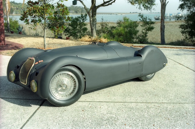

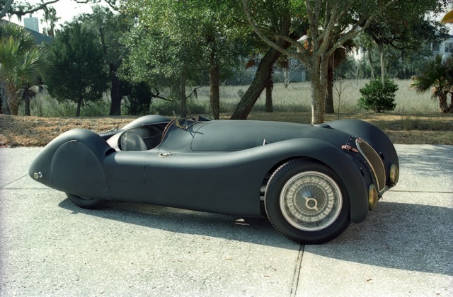

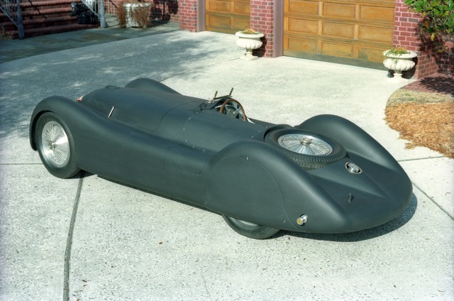

Here are some photos of a recreation of the 1937 ACF car Type 59/50B. I purchased the project from Ray Jones who had been working on it for nearly 10 years. It will be completed over the next two.
Quite beautiful and it should be a treat to see in person, as I believe that no one likely still alive has seen the car since 1937-8
magic pure magic.
wow, that looks stunning

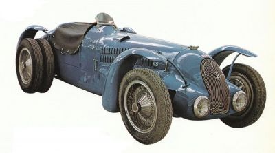

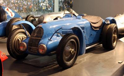

Here are pictures of the T59/50B in Schlumpf that were the basis of design for the replica T59/50B body on 57478:

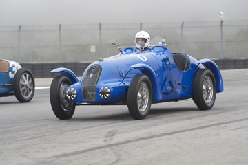

Here is 57478 with replica T59/50B body:
