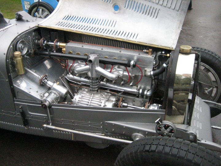

See picture of "37371" recently posted at Prescott.
37371
A “type 37C” which was originally fitted with engine 272 and delivered to Sorel’s London agency with an invoice dated May, 1929. The car is listed in Hugh Conway’s 1962 and 1973-5 Registers and, in the “Grand Prix Bugatti” it was listed in the ownership of Estes in California “with engine 43239” and in the UK BOC update in 2005 as having been imported from the USA by J. Proctor since 2000 but subsequently re-exported back to the USA. The car is also listed in the 1979, 1988 and 2003 American Bugatti Registers. It is still fitted with the eight-cylinder engine with the no. 112 from car 43239.

If it is a frame 37, the engine is a 35B, to see photo engine
The engines of T43 are almost identical to the 35B.

Isn't it necessary to adapt the T37 chassis to accept a T35 engine? For example the length between engine mounts will differ.
Can such a change be seen later (eg. the old location to accept the T37 engine mount?)
Of course you can see it. The rear engine mounts are at the same location. That's the alloy blocks that set the engine position in line (as spacer).
On the picture, you can clearly see the two first from holes for the T37 engine. You can also see the brake cable hole on the top of the spring leaves support, at the T37 specification.
The chassis are absolutly identical.

PostPosted: Tue Sep 23, 2008 3:30 pm
It is not as easy as Bugfan suggests. The ONLY difference between an T35 and T43 engine is that the T43 has narrower rear engine mounts. But a T43 engine can not be fitted in a T35 as the GP steering box would be in conflict with the right rear engine leg. A 35C or B has the steering box fitted higher(and further back) and it appears there is just enough room to clear the steering box. A T37A has even more room as the steering box is fitted even higher and further back and the picture clearly shows the T37A steeringbox position in this car.
But when fitting a T43 lower crankcase in a GP chassis the rear engine mounts have to be lenghtened by means of specially made spacers to bridge the difference in chassis width. (470 versus 650mm)
Common practice, also for fitting a T40 engine in a T37, is to cut the legs and weld-on GP replacements legs. Many T43 and particularly T40 lower crankcases have suffered this treatment.
