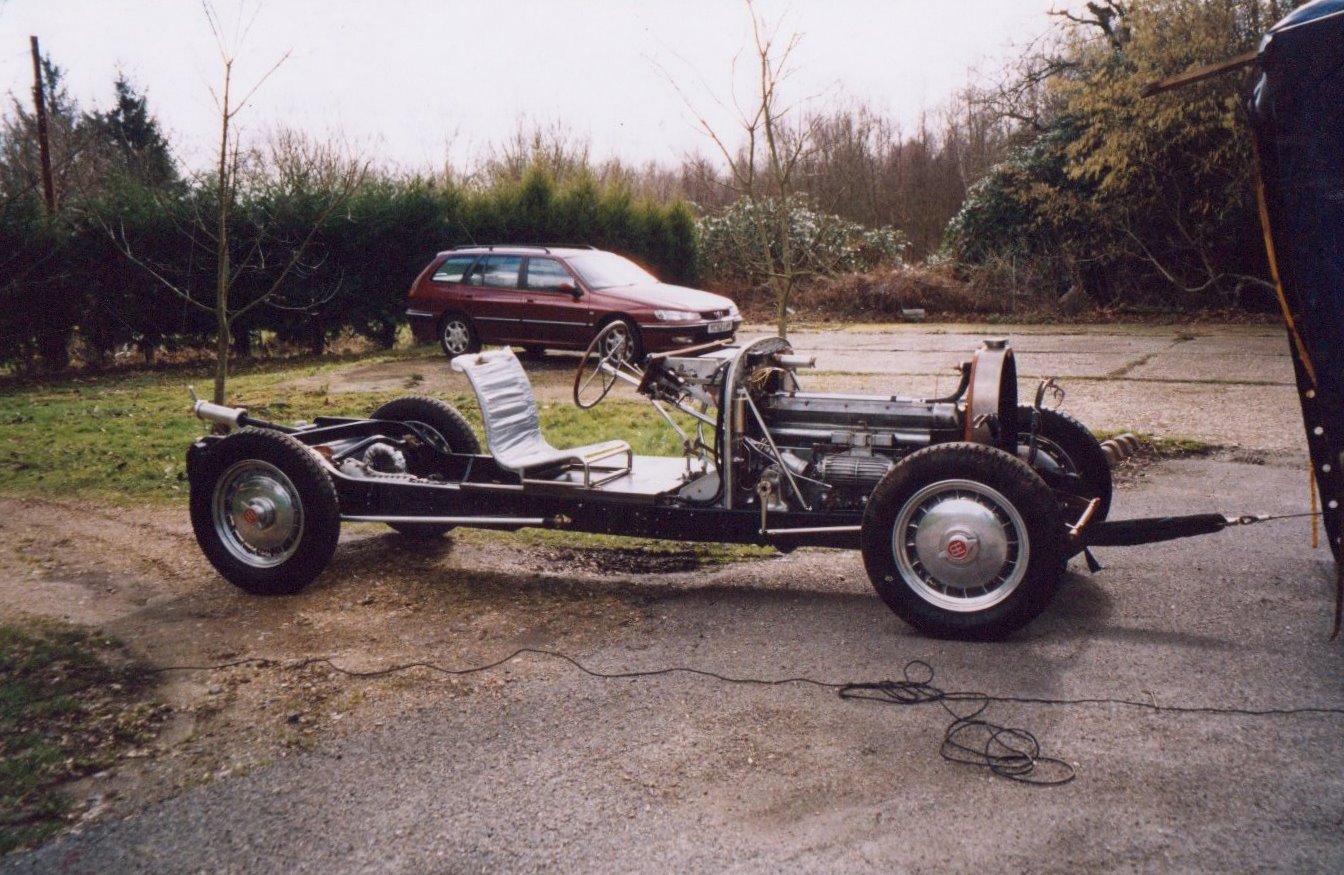

I restored this car so can add a little to this description.The frame was supplied by the molsheim works [as a type 50 frame ] after the war to the owner of a T50 which had been damaged i believe just before the war [ In Belgium or Holland ].The damaged T50 was not restored for many years until it came to be restored by Ernie Allen in the 1980's and a replacement frame was by this time unthinkable and in any event the original was repairable.I bought it for my customer in Austria and by this time it had aquired many other original parts,front and back axles [ the rear transaxle was an ex molsheim exchange unit ]etc. Barry Price was attempting to do the car but the owner took it away and sold it to me.Barry had aquired a T46 motor but when the Uno Ranch engines came up for sale I convinced my customer that it would be better to have the right engine.So the T50 motor was bought.The body is a copy of the Doctor Fuchs T50 which was very similar to his T41 Royale.Weinburger [the son is still around ] supplied the drawings.

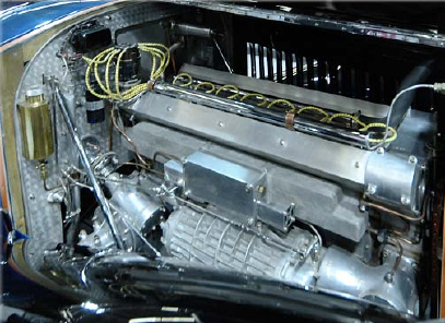

I had a quick look under the bonnet when it was in the UK in August.
Is the supercharger fitted the correct one for the engine. It looks like the smaller one
fitted to the 46S and the very early supercharged type 50 ?

we found an early T50 blower for this engine,Ray Jones outbid us on the original,even though his engine from the Uno Ranch sale had its blower fitted.He missed out however because our engine was rebuilt already! Our blower is fitted as usual with two Schebler carbs.here are both of the T50s that I restored.
