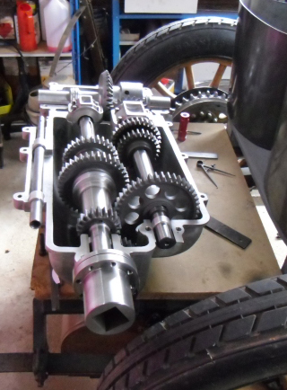

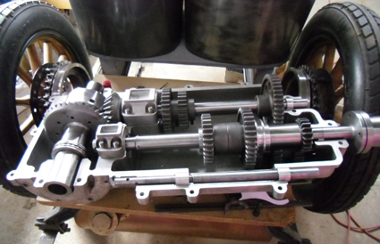

 Post subject: Re: T 5 gearbox
PostPosted: Thu Sep 19, 2013 12:26 pm
How the gearbox looks today . The bronze bushings are still missing .
