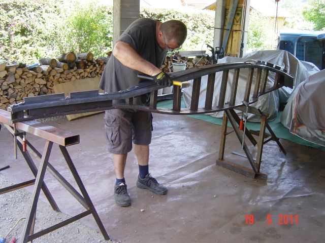

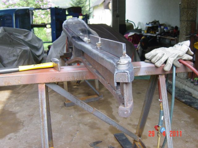

For you - pictures frame work
Bernhard

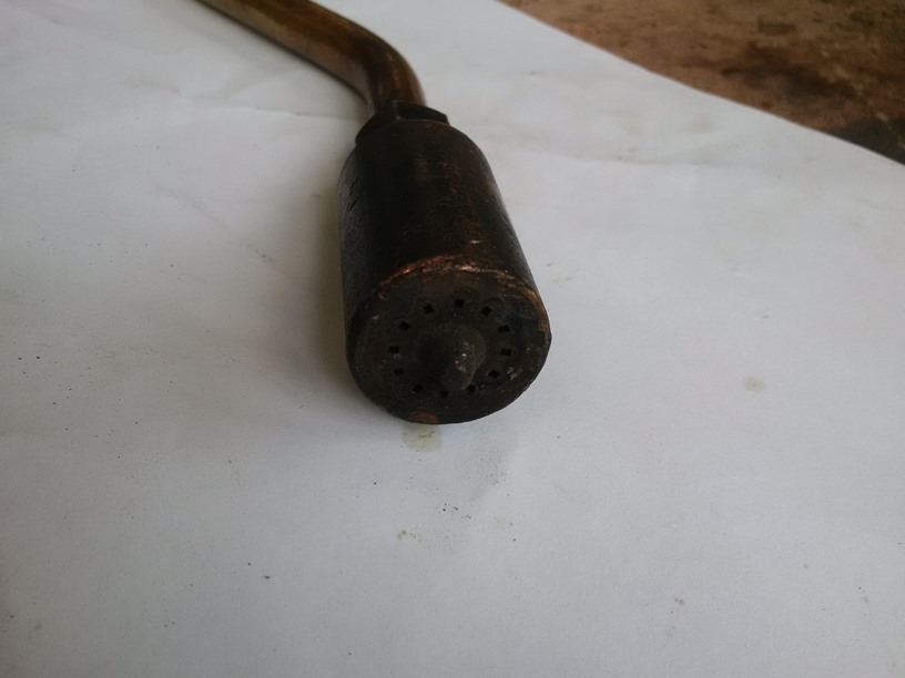

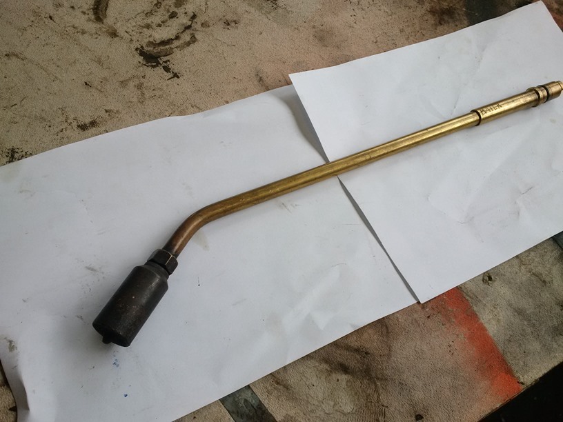

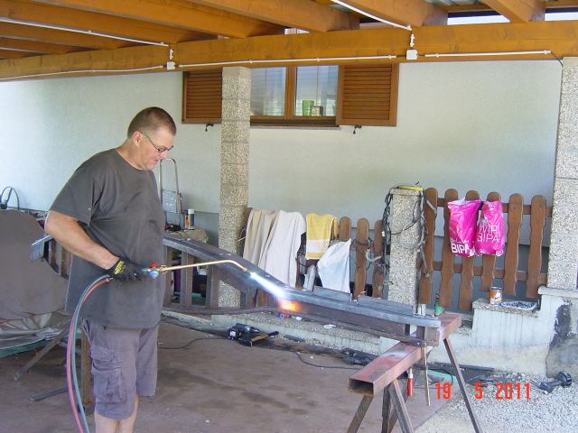

Can you show the nozzle , you used to heat it up . In German we call it Brause Brenner , do not know what it is in English .
 Post subject: Re: 35B Replica
PostPosted: Tue Jun 23, 2015 1:14 pm
Joined: Wed Feb 22, 2012 6:46 am
Posts: 18
Hallo Udolahr,
I am from Austria, we say "Büschelbrenner". Its a big one. I don't no the English wording also!
Bernhard

Aviatiker wrote:
Hallo Udolahr,
Bernhard
Most people I'm Britain would recognise them as pepper pots.
PostPosted: Tue Jun 23, 2015 10:41 pm
Hello Bernhard , "Büschelbrenner" sounds like a very logical name . Pepper pot explains it also very good . The german version Brause Brenner ( shower burner ). So what is it in french ? Can you show a picture from your Büschelbrenner ? I use one with 12 holes , but I believe a bigger one would be better . Do you have anythink to do with Aviatik ?

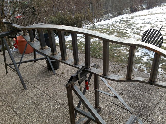

I can think of several ways to cut the 20mm plate, CNC waterjet etc. but how did you put the correct side curvature in place ?
Careful press work using a template and lots of heat ?
Or cold, and clamping to the cross stringers a bit at a time ?
Very nice work !
Ralph.

There are further pictures which make it more understandable and maybe give answers to your questions:

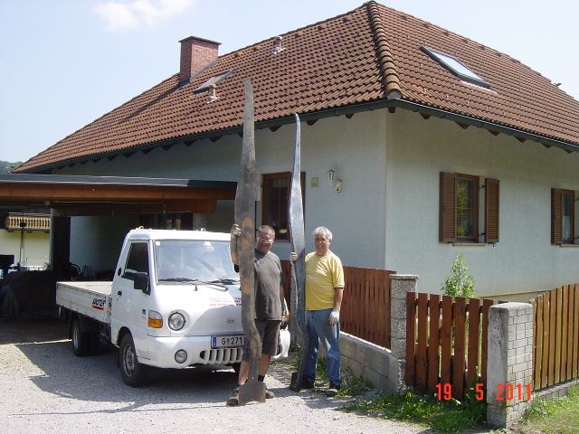

further pictures

further pictures

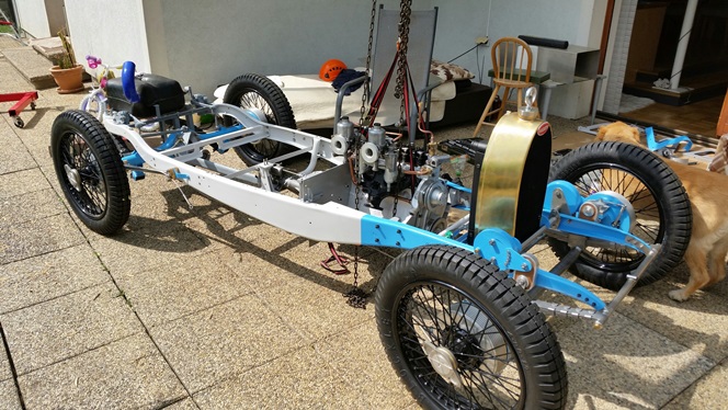

So, has anybody got any Type 35 / 37A drawings they've got spare?
PostPosted: Tue Jul 14, 2015 12:01 pm
Bugatti with 2CV fuel tank...new idea !!!
