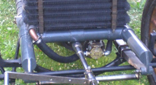

I did open one side , the top tube , with the milling machine . botem tube was open . And I did change the system to original , using the tubular frame to bring the water from the radiator to the water pump . The water is going from the engine to the back of the car , to the other side , and back to the front .
