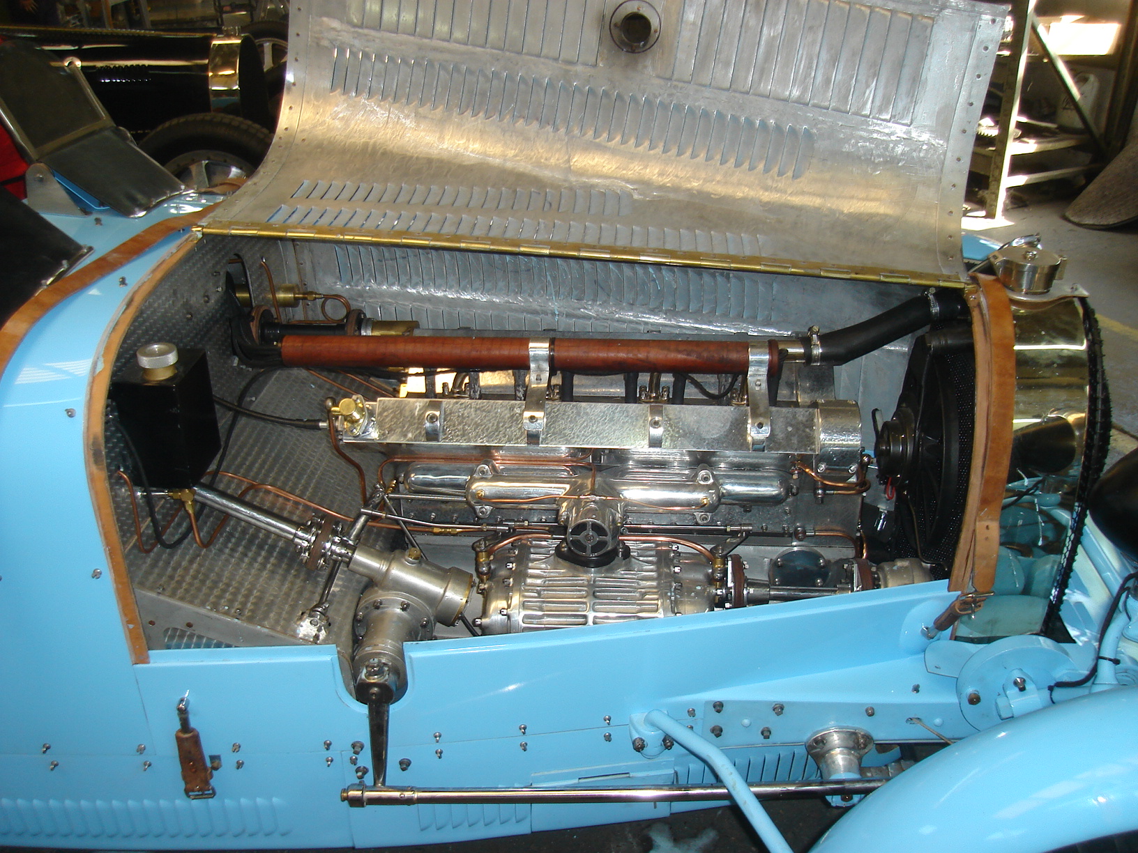

Photo of a Pur Sang AR Engine
File comment: Argentine Bugatti Engine
 Post subject: Re: Argentina Bugatti
PostPosted: Mon Oct 18, 2010 11:51 am
1. I'd like to know how £20.000 pounds on a finished replica would be spent on an AR car to make it drivable? Anyone like a share a fact sheet on what you need to do?
facts. Just some thoughts for the week.... :idea:
Photo of a Pur Sang AR Engine[/quote]
Thank you for sharing this very educational photo with us,Just a quick look reveals the following,The exhausts are quite dreadful and are the first PS parts that I ever saw at Beaulieu many years ago.They have copied an original with many welded repairs rather than the beautiful elegant original,The brass screw in the water pump should not be domed,the water pump greaser should not have a brass cap but steel.The oil pump is quite extraordinary,the ball and spring for the starting handle should not have a square headed bolt,I cannot see evidence of the pins that should lock the idler gear shafts in the blower drive,the breathers look very odd,are they steel fabrications? the oil filter could be a necessary evil,but evil it is.the bolts on the oil feeds to the front timing cover should be hexagonal not square,should not the bronze housing on the front have 5mm studs and nuts and not bolts? the nuts on the blower drive coupling should be castle with splitpins.This is at first glance,but an expert could no doubt find much more.What makes a Bugatti ? Does it matter where it is made? probably not,but a Bugatti is HOW it is made.This is not HOW it is made.

Further AR photos.
File comment: AR engine
 Post subject: Re: Argentina Bugatti Photos
PostPosted: Mon Oct 18, 2010 12:33 pm
Posts: 84
The photos above are for review. For years I have not fully understood why something copied can not be done precisely when all the drawings and originals are available for examination. It can cost no more to be precise in coping. It's obvious if parts used in coping are not correct , all are easy to compare to a Bugatti drawing. Comments on what we see is purely constructive in nature. Any copy should be as authentic as possible for the stake of the marque, it's no different in theory than installing a replica part on an original. If it's not right, it won't do - :|
On a secondary note, I raced against a few Argentine cars and they were as good as the drivers in handling the track, at full speed. That was 10 years ago, so I wonder how far they have come in those 10 years.
