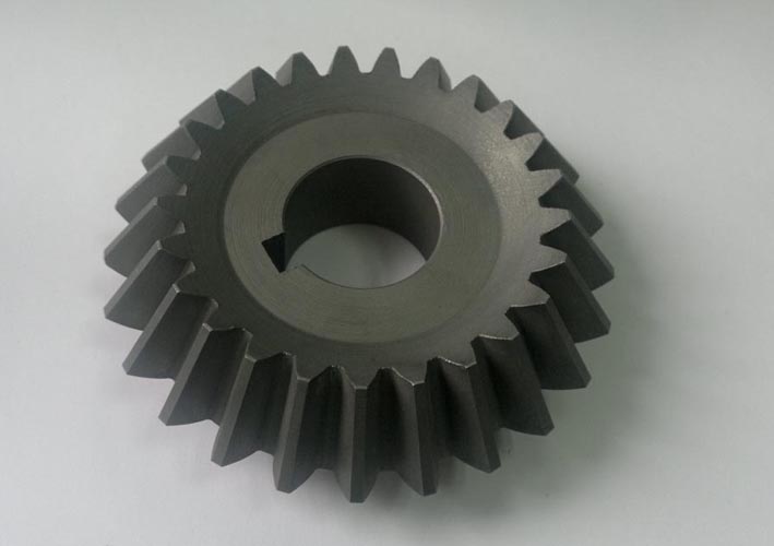

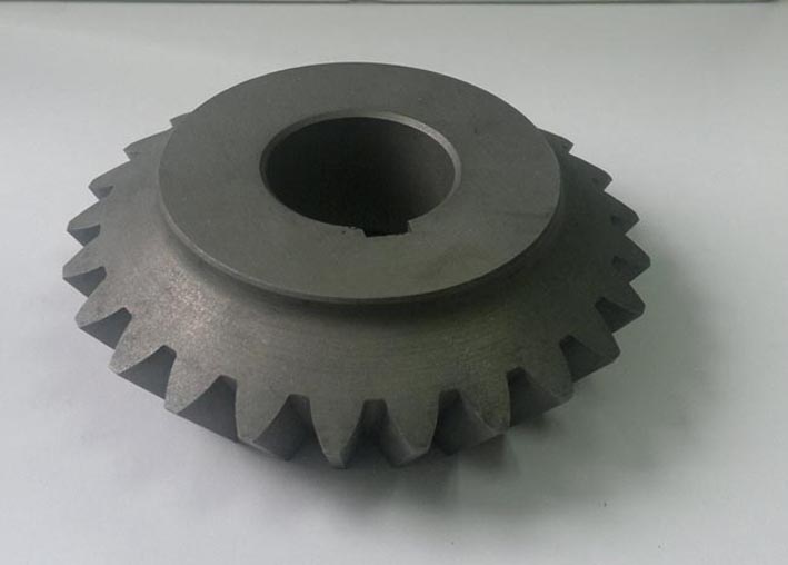

PostPosted: Mon Oct 22, 2012 12:50 pm
Type 5 bevel gear just after hardening .

I feel induced to respond:
1. I hoped to see bevel gears cleaned to see the difference in wor between frezer and blacksmith. On your pictures I can not see it. Some time ago I had got oryginal bevel gears. They were looked quite ordinary. I didn't see blacksmith's work at all.
2. Drawings that I saw on the picture are in English. Oryginaly they would be in French. Does't matter in what language they should have informations how to grind and harden them. So your question is rather strange.
