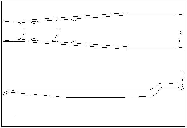

has anyone ever checked the chassis drawings for example t35 and t41 with a cad programm ?

I do not belive the story that the brits did change some dimensions to make the drawings unsuitable for production. Look , how many dimensions must I change to stop production of this part ? They made drawings with mistakes , after over 20 years driving Jaguars , I know this mistakes are not done on purpose . The Molsheim drawings have mistakes , in the t35 and t41 , the radiuses do not fit together .

What radius is different on the type 41?
 Post subject: Re: Chassis drawings
PostPosted: Thu Jun 30, 2011 6:01 pm
in the drawing 41ch216 radius at the rear end is 60mm ?
So what's the problem with the radius being 60mm - its just a fillet, it doesn't fit into anything.
PostPosted: Sun Jul 03, 2011 2:11 pm
If you think so . If I build a Bugatti part , it has to be like the original and not fantasy . If I do not care about it , I can change any dimension . It looks like the drawing 41ch216 is full of mistakes .Is there any other t41 drawing for the chassis ? maybe Bugatti did not use 41ch216 .

If you take the chassis drawing 41ch216 and look at original chassis fotos , suddenly there are some questions .
PostPosted: Mon Jul 04, 2011 12:33 pm
Maybe you can make a scan of the drawing, as well as posting a photo of the actual chassis?
That way also those few of us who do not have access to 41CH216 can see what this is about?
PostPosted: Mon Jul 04, 2011 1:09 pm
I will look , if I can show a cad drawing , have to change the file to something .

dwg or dxf ?
PostPosted: Mon Jul 04, 2011 3:26 pm
voila
