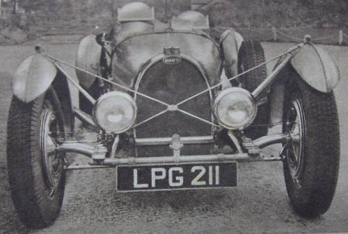

I want to build the LPG 211 car as a 1:18 scale model based on the Bburago diecast, with the road-going wings and headlights as it appeared circa 1960.
The only color pictures of the car at that time look to me like the paint is a metallic blue, which would be quite unusual. Does anyone know if the paint was, indeed, metallic? If not, which of the specific Bugatti colors would it be?

Another metallic-paint romantic! I too had a wonderful time trying to discover if the Pope Atlantic was indeed a dark metallic blue - found out it was not, merely the ageing of photographs giving an illusion.
LPG 211, as best I can tell, was painted a close approximation of traditional Bugatti blue by the same owner who fitted the road-going equipment. Kindly note this is merely an observation on my part and must not be seen as proof.
Recently Mick Walsh wrote a brilliant article on this car in Classic and Sports Car ; when I get home tonight I'll see whether he wrote anything on the colour.
Good luck with this project ; the Bburago is just crying out for a set of decent wheels, but how that can be achieved is beyond my ability. When done please share with us.
Kind Regards
PS. I think the Bburago might, I repeat might, be close to the original colour.

But at what time :lol: This car has been painted 3 times in blue...
Original by Pope (Dark saphir), by Price (French blue) after accident, and by Bamford (Blue saphir) ?

One more thing: The Ludington 59 as shown above appears to have a gray or metal finish on the underside of the fenders/wings. Does anyone have any insight about which color that should be?
Yet one more thing: There appears to be some sort of badge on the crossing of the wing supports in front of the radiator in the color pictures, while it appears at the lower portion of the frame crossbar in the historic photo. Can anyone tell by its shape what that is?
Is this it?

Yes, that is the one.

See this picture; the position of the badge has been different also, mounted on the front cross bar, not on the X.
Yes, you can see it in that position in the picture above of the car at speed. Thank you for your picture – I haven't seen that one. Do you have others?
Sorry, I don't have more.
Just found this one today on Ebay (was for sale...)

While there is very little available in pictures of the left passenger side of this car, the exhaust pipe and resonator appear to be wrapped in cloth for about 1/3 of the pipe's length to reduce noise, or maybe to reduce heat. That, the horns, the wings and headlights would indicate to me that Mr. Ludington was more interested in using this car as a (somewhat) civilized road-going vehicle rather than for racing.
